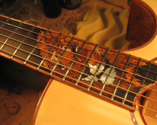

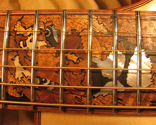

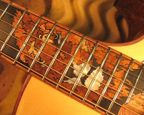

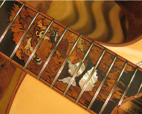

     I just wandered in from doing the final fret polishing and set up on the African Missions Trip Guitar. The inlay held onto the continuity of its subject matter nicely and looks fine broken up by fret and string lines.
   Here are a few photos of the fingerboard inlay under frets and a set of strings and I'll post some nice shots of the entire finished guitar later today or tomorrow.

Great job Kevin! What thickness are the bindings on your fretboard please? it really looks good and proportionnal.

Hi Kevin - I like how you kept a black line at the edge of the inlay down the side of the fretboard - how was that done ??? Was it bound in, or just careful routing and then touch sanding the inlay pieces to fit straight and tight against it ???TonyKarol38898.3430555556

Serge,
   The fingerboard binding id Bubinga measuring .080" thick and inside of it are two purfling lines eac measuring .020" one of which is Ugandan Cypress and another of Bloodwood.
   The body binding is alos Bubinga, but measures .075" thick.
Tony,
   That thin black line between the inlay and the fingerboard purfling is simply fingerboard that is left in place. I like to border anu inlay that is able to fill the fingerboard by leaving this thin line because it allows the impact of the purfling scheme to remain powerful.
